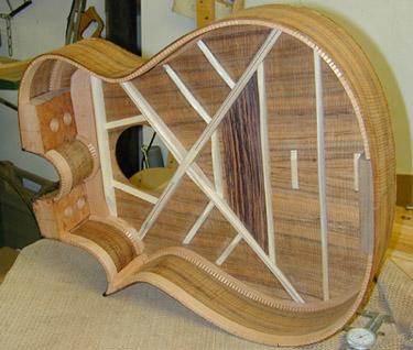

Here is the innards of the one I built ....

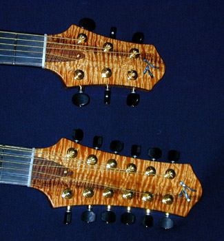

And here is the top view once completed.

So Tony, How does she sound? She sure is beutiful, that is nice lookin Koa (?). I am also using this brace system (Larrivee symetrical) but man you did a nice job! Is your cross laminated with carbon fibre or something?

Hi All,
It was jsut over for a visit last night, to show one of my students. He thought is was amazing. A lot of folks arent amazed by the sound, but by the playability of the 12 side - its like butter.
IMO it is a good sounding guitar, but in designing and building it, the first priority was for it not to explode once strung at concert pitch. We took the sound for what it was - I designed the whole thing myself, as far as the innards went, and I must way it turned out great. Its got PUs in her as well, the side mount Baggs with a neck selector switch (or is that a bridge selector switch !!) Baggs under saddles, the coax cable type. They were a bear to get sounding even across the strings compared to others I have used. The guitar is certainly not bass heavy, even though its a 16 3/4 lower bout. Its crisp and clear though, and he loves it to death.
The owner is in a BonJovi tribute band, and always wants whatever Ritchie is getting his hands on ( yeah and her too !!) to keep the band looing up to date. He only has 24 guitars, so hes halfway there !!!
The main X is 10x18 mm with 20 thou Cf in the midlle. Even with all that mite in there, the necks still affect each other when tuning up. Its kinda like a floating FloydRose type bridge without the whammy.
But one thing is for sure - you learn alot doing one. I thought I had the necks all set up, and then the client points out that the two headstocks arent quite even, one was a tad lower than the other. So I say, no prob, watch this. I do a few sandpaper pulls, and there it is, dead on. You could lay a ruler across one headstock face, and it just lays on its brother - beautiful.
Cheers, Tony.

I see CF in those braces Tony, am I right?...
I was thinking of something with two actual seperate bridges and X braces that crossed over at the center (Kind of like gibson did with some of their ealier acoustics), the necks would be parallel and a little wider apart than yours. I would not need any lower finger braces with a pattern like that, the 12 string side would have taller bracing and the 6 shorter but it would all be CF lams as I normally do.
The two scales would be identical and the guitar symetrical, I'm doing some layouts tonight to see if I can get the basic measurements down, since I still don't have a shop I'm using some my older ones to lay things out...

I see where you are going with the 2 X's and the somewhat separate X heights. I would think that you may need a touch more height at the 12 , but I would nt put too much. The top is still going to work as a whole, and I think you might actually end up overbracing with the double X. Not sure how to figure out what sizes to use either. But you could always get in there and shave a bit post stringing up, and see how that gets the sound to open up.
